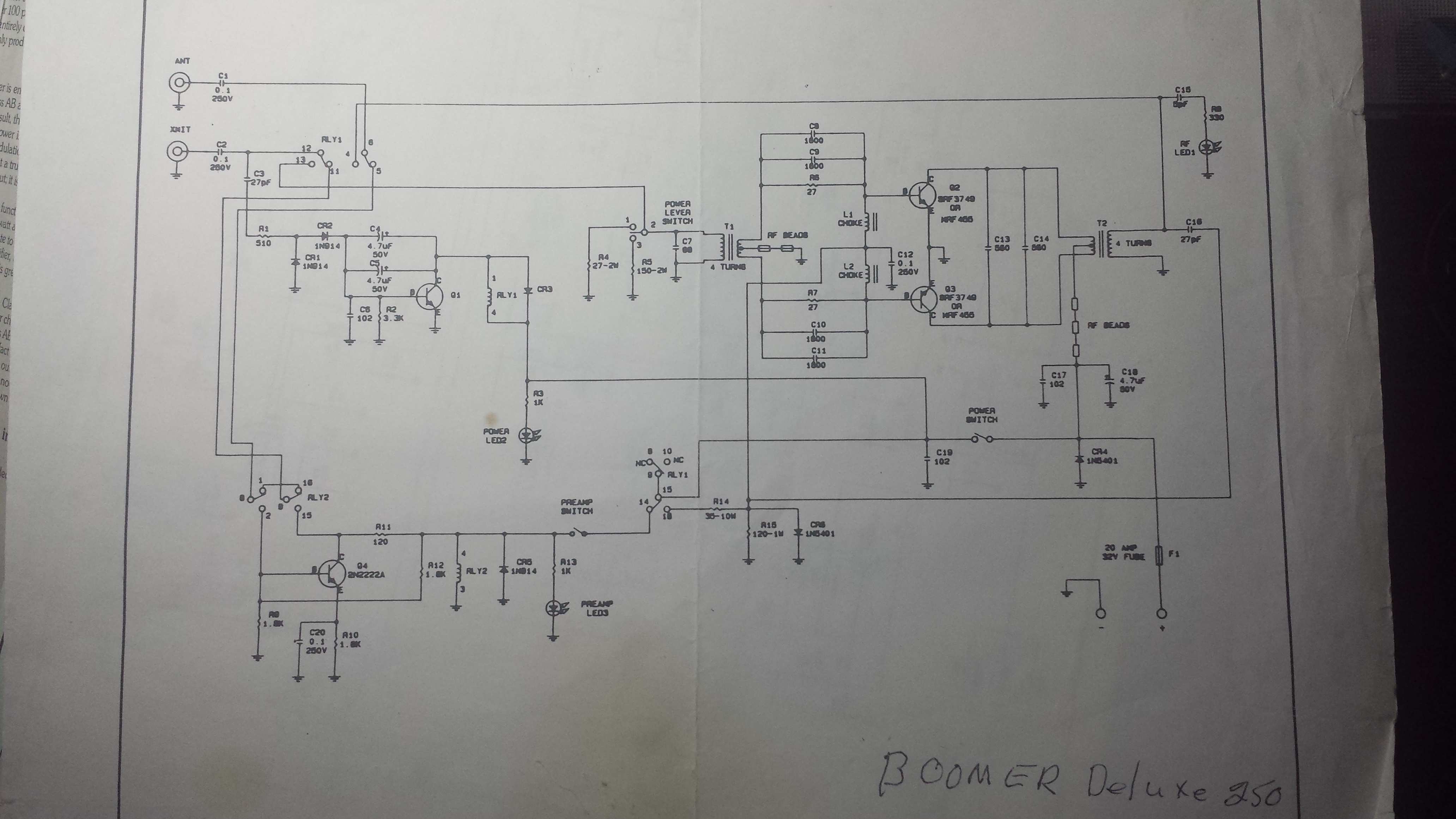

This is the same as the Shooting star 225 Plus with 2sc2879 pills. Bord layout was the same also.
Boomer 250, Shooting Star 225
(3.27 MiB) Downloaded 60 times
