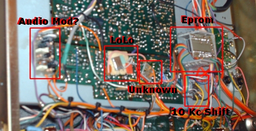

Here is a Pic of the Mods in the Jumbo:
I'm not 100% sure but i think that the "Audio Mod?" is actually a standard part of the jumbo. Notice how the 10Kc shift mod has been built on to the legs of the chip and is just left floating... Never heard of vero-board then? :roll:
The "unknown" mod is about 1cm square and has a couple of diodes and a couple of capacitors on it and connects to pin1 of IC2 and ground. I'm not sure where the orange wire goes.
All of these mods work ok, but man they look messy and that irritates the hell outta me :x

That Eprom board looks very very much like one of mine but the audio mod is not, if it is one of my Eproms it'll have DZ63 on it somewhere.
A closer photo of each mod might be better as that one looks like what I do with the web cam, crap to say the least.

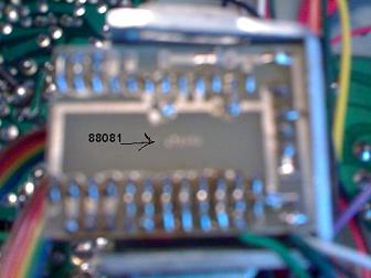

I'll look tomorrow to see if i can see your ident anywhere on the eprom board
UPDATE: Here are better(?) pictures of the eprom board.
The actual eprom used is: Hitachi HN462732G and has 02A written in pencil on the white sticker on the top
UPDATE 2 I have been looking into why the wires from the tune switch have been removed. When the radio is put in UK mode, the eprom is switched and also a resistor is switched in across the tune pot to give the UK offset, therefore the tune switch has to be set permanantly on or it could not bring the frequency down. I'm thinking that it would probably be better to pull the HI band mixing crystal down by 3.75 Khz and then the tune switch could be rewired back to normal. This would then also allow correct operation of the tune pot when on UK band.

The Eprom board now looks to me like one of Spectrum communications Eprom boards with the 5v regulator soldered to the board and then screwed to the chassis to hold it in place and the number will probably be a date code.

Dave, I think you nailed it! =D> I went to the Spectrum Communications website and guess what? They do an eprom board called SC02A which just gives UK band in Cybernet Radios. I've sent Tony at Spectrum an e-mail to confirm this.

UPDATE it has now been confirmed that the eprom in my Jumbo is A Spectrum Communications SC02A board which gives UK band only. So this is why the radio has a seperate LoLo mod.
