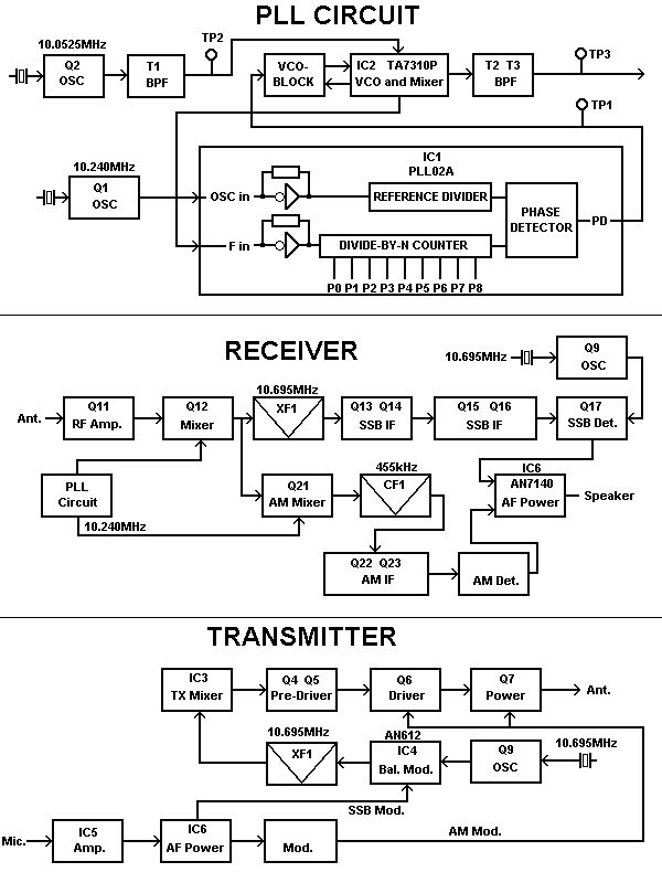

Preset to channel 40, mode USB, clarifier centered.
The Mode in brackets ( ) indicates which mode the radio should be in.
| Reading Point | Adjustment | Description | Value |
| IC1, pin 3 | - | Check for 10.240MHz +/- 50Hz | 10.240MHz |
| IC4, pin3 | CT6 | (USB) AM/USB Carrier oscillator | 10.695MHz |
| IC4, pin3 | CT5 | (LSB) LSB Carrier oscillator | 10.692MHz |
| TP2 (IC2, pin 4) | CT2 | (USB) AM/USB offset oscillator | 20.105MHz |
| TP2 | CT1 | (LSB) LSB offset oscillator | 20.1035MHz |
| TP3 | T1 | 0utput to RF local oscillator | 37.660-38.100MHz for CEPT |
| TP1 | VCO-Coil | VCO DC Voltage (DONT ADJUST IF WORKING OK!) | 1.2 Volts @ channel 40 (27.405MHz) +/-0.5V |
Preset to USB, channel 20, inject 2400Hz, 10mV audio signal.
| T2 | VCO Mixer Output | Maximum RF output power / best signal on oscilloscope at TP3 |
| T3 | VCO Mixer Output | Maximum RF output power / best signal on oscilloscope at TP3 (check even on channels 1 and 40) |
| T4 | Transmitter Output | Maximum RF power output |
| T5 | Transmitter Output | Maximum RF power output |
| L16 | Transmitter Output | Maximum RF power output |
| RV4 | Final Bias (Q7) | Connect DC Voltmeter to Q7 base (junction of C55, R34, L13) adjust for 0.70V |
| RV13 | SSB Modulation | inject 2 tones, 500Hz and 2400Hz, at 10mV, adjust for 12 Watt pep |
| RV7 | Carrier balance | Check / Adjust for NO Carrier on both LSB and USB |
| RV15 | AM Output Power | Remove injected audio, Adjust for 6W carrier, a lower power level may be required to attain full modulation. |
| RV14 | AM Modulation | Return to single 2400Hz tone @7mV, adjust for 92% modulation (see note above) |
| RV6 | RF Power Meter | Adjust to match actual RF power |
Preset to channel 20, USB, clarifier centered, NB/ANL turned off, RF gain set to maximum.
Be ready to inject a RF signal with an RF signal generator.
| RV8 | SSB AGC | ?? |
| T6 | RF Input | Inject RF signal of 27.205MHz, 1KHz, 30% modulation, (keep the level low to prevent AGC action), adjust for maximum on radios signal meter / audio level at speaker (as measured with a scope or AF-VTVM) |
| T7 | RF Input | as above. |
| T8 | RF Input | as above. |
| T9 | 1.F. | 10,7MHz, as above. |
| T10 | 1.F. | 10,7MHz, as above. |
| T13 | AM IF | 455kHz, as above. |
| T14 | AM Detector | 455kHz, as above. |
| T11 | SSB IF | 455kHz, as above, also set for maximum audio output. |
| T12 | SSB Detector | Set for maximum audio output. |
| T6, T7 | turn both approx. 1/4 of a turn clockwise | |
| RV10 | AM S-Meter | Set RF signal generator to inject a 100uV signal, 1KHz, 30% modulation signal, adjust for "S9" in radios signal meter . |
| RV9 | SSB S-Meter | Remove audio from RF signal generator, set for "S9" on radios signal meter. |
