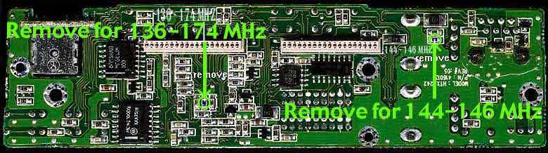

   We will be working on the backside of this last board
There are 3 frequency ranges to choose from.
   The 144-148 MHz FCC band (Already installed)
   The 144-146 MHz European band.
   The 136-174 MHz US Emergency Services/business band
Remove one of the two parts shown below. BUT DO NOT REMOVE BOTH
