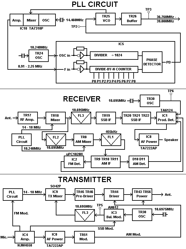

PLL Circuitry. PLL is an abbreviation of the phase-locked loop which is fundamentary composed of a closed loop feedback citcuit. The feedback component is the balance of frequency drift and the PLL circuit acts to cancel it out. To detect out the frcquency drift of the PLL output, a fixed reference ocillator (10 kHz, 1/1024 divided down from 10.240 MHz) is compared constantly with the input frequency (10 kHz). The input frequency is obtained by dividing the VCO frequency. A functionalI block diagram is provided below under "PLL Circuit" for the easier understanding.
Off-Set frequency oscillator IC10. The off-set-frequency oscillator IC10 oscillates at 14.460 MHz for all band.
Switching between these oscillating frequencies is made by biasing the diodes D34 to D36.
The off-set frequency signal is obtained at IC10 Oscillator and flows into IC10 Mixer where it is beat with the VCO signal. The VCO signal is obtained from the following:
f vco = foff-set + Nfr
Where, f vco = VCO frequency, N = programming code for divider output, and fr = referency frequency step (10kHz).
i.e.: At channel #1 in band A, and band corresponding N code is 91:
f vco = 14.010 + 91 x 0.01 = 14.920MHz.
Since the mixer output determined by two factors the off-set frequency output (dependent on band selector
switch) and the VCO output, the mixer output contains the subtracted frequency of 0.91 to 2.25 MHz. These frequencies appears in pin #2 of IC5, and divided by the programmable divider in IC5 down to 10 kHz which is compared with another 10kHz signal obtained from the reference oscillator TR24 (10.240MHz).
The VCO output is mixed with the off-set frequency signal and applied to the TX mixer IC9 through band-pass filters.
i.e. At channel 1 in band A, and AM band, the TX mixer IC9 accepts 14.920 + 10.695MHz = 25.615MHz is TX frequency.
When receiving channe 1 in band A (26.065MHz), the 1st RX mixer TR18 accepts 15.370 local ignal at its base, and converts down it down to 10.695MHz IF (for AM/FM mode, this is the 1st intermediate frequency).
TR18 off-sets the 10.695MHz signal so that TR30 can oscillate at 10.6975MHz for LSB.

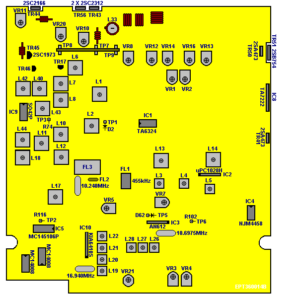

| Reading Point | Condition | Adjustment | Procedure |
| PLL | | | |
| IC5 Pin 3 | - | Check | 10.2400MHz |
| TP2 | Band:D, Ch.:40 | L17 | 5,0 Volt |
| TP3 | - | L18 | Maximum on Oscilloscope |
| OSCILLATOR | | | |
| IC10 Pin 9 | AM | L19 | 16.9400MHz |
| IC10 Pin 9 | USB | L20 | 16.9425MHz |
| IC10 Pin 9 | LSB | L21 | 16.9375MHz |
| IC10 Pin 9 | TX AM | VR21 | 16.9400MHz (TX-Frequency) |
| TP5 | TX AM | L26 | 10.6950MHz |
| TP6 | RX USB | L27 | 10.6925MHz |
| TP6 | RX LSB | L28 | 10.6975MHz |
| TP5 | TX USB | VR7 | SSB Modulator Balance |
| RECEIVER | | | |
| RX AM | L6 L7 L8 | RF Input |
| RX AM | L10 L11 L12 | AM/FM/SSB IF |
| RX AM | L3 L4 | AM/FM IF |
| RX FM | L5 | Discriminator Coil (FM Demodulator) |
| TP1 | RX USB | L1 L2 | Noise Blanker IF |
| RX USB | VR3 | SSB Squelch |
| RX AM | VR4 | AM/FM Squelch |
| AM/FM S- Meter | RX AM | VR1 | |
| SSB S- Meter | RX SSB | VR2 | |
| TRANSMITTER | | | |
| TP9 (+) TP8 (-) | Bias Driver | VR11 | 10mA |
| TP9 (+) TP7 (-) | Bias Finale | VR10 | 100mA |
| TP9 (+) TP7 (-) | Bias Finale | VR20 | 100mA |
| TX AM | L42 | Maximum |
| TX AM | L43 | Mixer Coil (VCO-frequency input) |
| TX AM | L44 | Mixer Coil (TX-carrier 10.695MHz input) |
| TX AM | L40 L42 | Maximum RF output |
| TX AM | L33 | Minimum Harmonic |
| TX AM | VR13 | 15 Watt (30 Watt with Dual Finale output) AM/FM |
| TX USB | VR12 | 20 Watt (40 Watt with Dual Finale output) SSB (ALC) |
| TX AM | VR14 | 90% AM-Modulation (AMC) |
| TX FM | VR5 | 2 kHz FM-Deviation |
| TX CW | VR16 | CW Tone (Not in all model`s) |
| Power Meter | TX AM | VR8 | |
