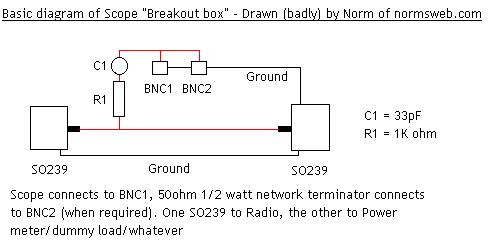

Ok, Here is the finnished "Breakout Box"
It has a second BNC connector in parralel with the first, that fits a 50ohm 1/2 watt network terminator from my old computer junk box to give 50 ohm load to scope as required.

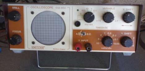

The only problem is that I dont see any audio on scope... if I remove the 50 ohm terminator I can see tiny movements on the scope.
Here is the circuit I built:
I dont think I made any errors in the build... I fear that my basic scope may be just too basic for this task :cry:
However, if i connect scope directly to collector of Q9 (ptbm059) I get good audio on scope :?

First of all, if you require multiple BNC outputs, they should each have their own network (the 1K resistor, the 33p capacitor, and the 47 ohm resistor).
Otherwise, all sorts of loading and RF effects can happen.
If you have some BNC terminators, then use a "T" adaptor at the 'scope end and not inside the box:
2 x SO239 centres --- 1K resistor --- 33p capacitor ---BNC:BNC---------"T"--SCOPE INPUT--"T"---50 ohm load
i.e. "SCOPE INPUT is the centre of the T adaptor.

Mine work with the values given - Ive made a 4 BNC port unit (signal generator / counter / scope / spectrum analyser).
Each BNC has a separate 1K resistor / 33p capacitor, but I didn't use the 47 ohm as the test gear has either got an inbuilt 50 ohm load (scope and counter) or has T pieces with 50 ohm BNC loads (sig gen and spectrum analyser).
If it shows a freq on the counter but not on the scope, then there is some sort of loading / reactance issue - this is unlikely. In my Uni days, I used an old hand-me-down scope (rated at only 10 or 15 megs) that worked fine for viewing modulation on 27 meg AM transmitters.
You should be able to find it easily enough with a multimeter and maybe some component substitution.

Hi Sue, I had written a lengthy reply to you, but my internet connection went up the spout and it got erased :violent2:
Here are the main points:
2nd BNC was only fitted to take terminator. Checks with FC confirm that box is working ok. Scope set to 0.05 volts/div shows no carrier. No audio on scope with 50 ohm terminator, very small audio on scope without terminator. (even using T junction at scope end)
My scope came from a science lab in a Uni, thats how i fear it may not me up to the job...its a UNILAB 032.602.
I hope my internet connection lets me post it this time ](*,)

Hi Sue, thanks for taking the time to help me.
I'm pretty sure that my scope is not as old as 60's, It's transistorised and there are a few 8pin DIL chips in it:
Scope internals
Scope internals
Scope
Scope
It may be 70's-80's I dont know. I could find no info on it myself when I looked online. I think its one thats specially designed for use in schools/universitys, and probably not designed for "serious" work. It is pretty good at finding audio faults in stereo equipment, which is what I mainly use it for.
The maximum Timebase is 100ms/div
The minimum Timebase is 0.1ms/div
it also has a Timebase variable from x10 to x1
The maximum Volts/div is 10
The minimum Volts/div is 0.05
And yes, you guessed it in one! I got it cheap off ebay!!! Maybe it is time for an upgrade :-k
UPDATE just found this info about my scope, it seems that this scope is still a current model, but mine is a few years old...
Student Oscilloscope
• Inexpensive, single channel oscilloscope with simplified control layout for student operation and permanent triggering feature • Introductory unit to teach the basics of oscilloscope use with a useful set of features e.g. 8 switched gains from 50mV to 10V per division and a timebase with switched ranges of 1, 10, 100 or 1000ms across screen with variable x 1 to x 10 control This extremely popular educational oscilloscope is robust and easy-to-use. The flat screen is 70mm across a diagonal with graticule marked in 10 x 10 0.5cm squares. Focus, Brilliance, X shift and Y shift controls determine the position and nature of the trace. A Y input can be passed to the Y amplifier directly or through an internal capacitor to block a d.c. component. The steel case is fitted with 1.8m of mains cable, a carrying handle which can be used as a tilt stand, an on/off switch with indicator LED, and cable wraps at the rear. Y amplifier: FET input, 1M d.c. to 100kHz X amplifier: 1M d.c. to 200kHz Sync. Input: 1M input, triggering at 20mV Mass: 3.6kg Size: 245 x 310 x 100mm
So it appears that my scope is just a 1 meg, that would explane a lot! :roll:
Norm
lbcomms
Posts: 157
Joined: Monday 27th Feb 2006, 22:57
Location: Australia
Re: Ham Jumbo MK1 - No Swing AM
Post by lbcomms »
That's pretty "basic" :)
With a minimum like that, its going to go nowhere near 1 meg. Your "just 1 meg" is the input impedance, not the top frequency.
The inverse of 0.1mS (1 / 0.0001 seconds) = 10Khz, and with 10 marked divisions you can show 5 of these (2 div per cycle) your limit is 50Khz (0.05 Mhz)...
It barely makes it into audio :D
It looks like mid 80's vintage to me, after looking at the pic of the internals.
There are two ways around it - you could either upgrade to something more suitable (quicker and easier, but costs $) or make up a "downconverter" to convert a 27 meg or whatever frequency signal to the 50Khz the scope can handle (very little $, requires knowledge of low level linear amps, mixers, and PCB constriction amongst others, and lots of patience / time).
Personally, I'd spend the fifty quid or so a used 20 meg unit.
Sue
