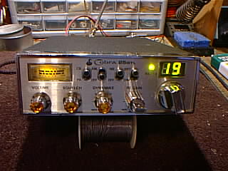

- Custom Built Unit
DM CB Radio Products
All Yellow LED lighting - cobra25yellow.JPG (22.72 KiB) Viewed 10252 times
