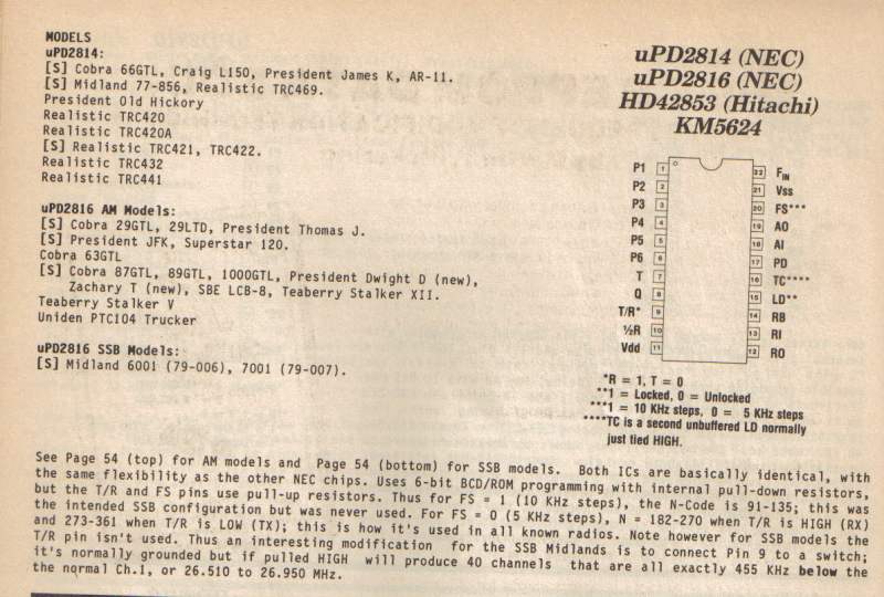

Hello to all, maybe someone could help to obtain the datasheet to uP2816C, and be able to continue checking my cobra 29.
Thank you in advance

What do you need,just the pinout of the pll.
Or do you need the specs as well.

Actually it would be nice if there was an online source of PLL data sheets, however I have the info in the PLL data book, when I get to the shop, I could try and scan it and post it here, if this forum accepts images.
EDIT: Here ya go!

I need a specs, or tests circut, any tech info

[quote="timrim"]Actually it would be nice if there was an online source of PLL data sheets, however I have the info in the PLL data book, when I get to the shop, I could try and scan it and post it here, if this forum accepts images.
EDIT: Here ya go![/quote]
Thank´s timrim, good file, whit this I am undestanding
