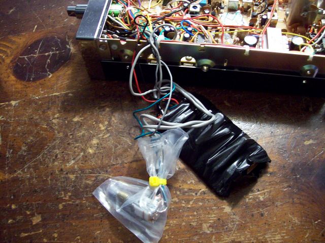

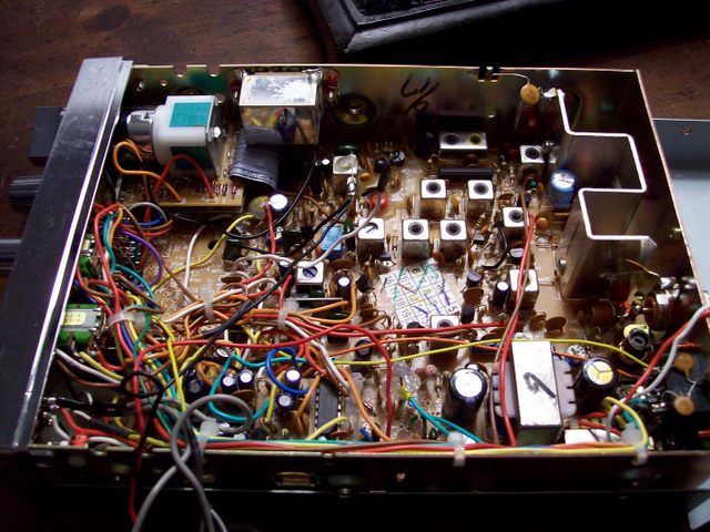

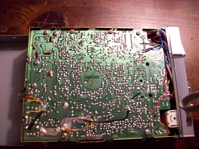

I have found a wire that has been cut. That is all that I find. I get a lot of squelling when I have the ST turned On. Here are some pictures of the radio.

- The wire that is cut is above the first silver pot from the left. It is kind of dead center. Black wire connected to white wire.

From looking at the pictures someone has done a swing mod. to this radio this is why you have a low carrier. To be able to raise your carrier you have to change the resistor to a higher value that is located on the solder side of the board located were JP6 used to be or you can remove the electrolytic capacitor and the resistor located at JP6 and install a jumper wire back as it was from the factory. As for the squeal or hum that you are getting in transmit check to make sure the echo board is grounded properly. Hope this helps good luck.

Thats right on timrim,Looks like from the pic. the best i can see
they are using a 100 ohm resistor on swing kit.This usually
produces about 1 watt to 1 1/2 dead key..I always use a 51 ohm
here,This will give somewhere between 2 and 2 1/2 watt deadkey.
This way you can set your swr meter cal., Also if you get that
dead key down to low, it tends to get alittle choppy on audio.
Also the relays in some amps will not even latch at 1 watt key.
Which if continued use will burn out the relay.So if you want to raise
the dead key,change that 100 ohm resistor to a 47 or 51 ohm resistor.
As far as the feedback squeal goes.It looks to me, again the best i can
tell from the pic. That the talkback is wired either to a switch making
it switchable,Or they have it going to one of the controls,Making it
variable.It has a resistor in the heatshink it looks like.So i would
guess it is probably going to one of the switchs.Anl/nb,ch 9,or either
the cb/pa switch.Probably the Anl/nb switch seeing this is the most
logical and easiest method.If it is switchable,just set your echo the way
you wanna run it.Then turn the talkback off.THis should take care of your
squeal.But if you insist on using talkback,Then cut open the heat shrink
and see what value resistor they used.I always get good results using
a 100 ohm resistor here.The talkback will be loud enough,but not
too loud causing a bunch of squealing.
